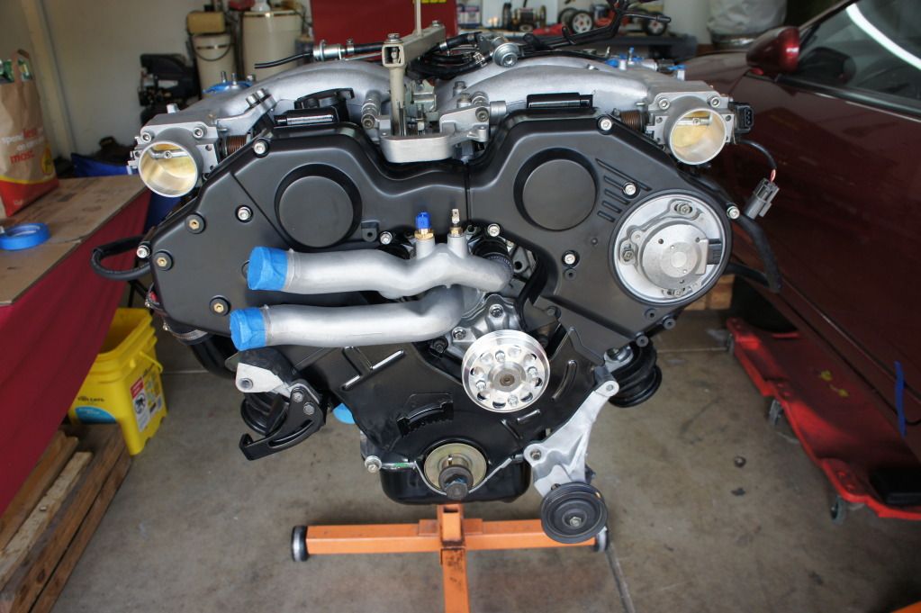

Pulled my engine this last winter for a bunch of maintenance and a few changes including:
-New main and rod bearings.
-Complete gasket kit except head gaskets(didn't remove heads).
-New valve stem seals.
-New oil pump(see pic for why).
-Rebuilt lifters.

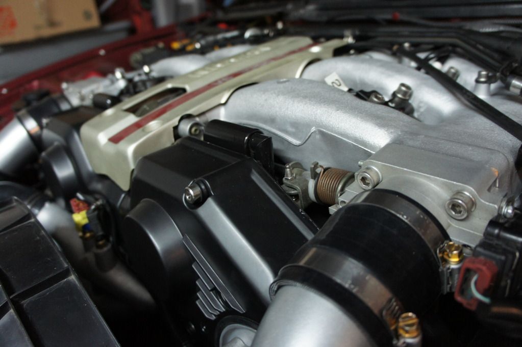

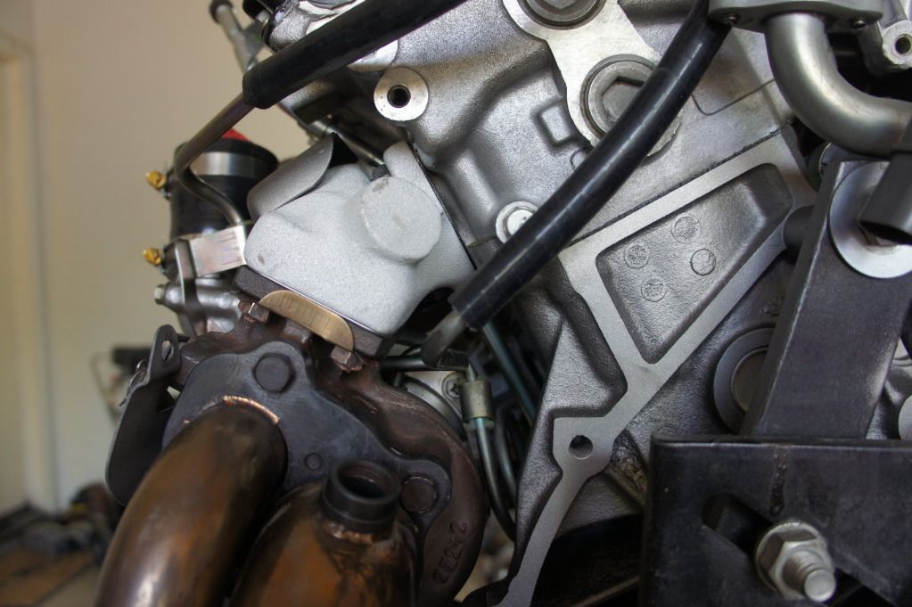

-Replace ams manifolds with swain coated MSP's.
-Strip and re-powdercoat ashspec ic pipes silver(they were black).
-Install Ashspec planar inlet pipes.

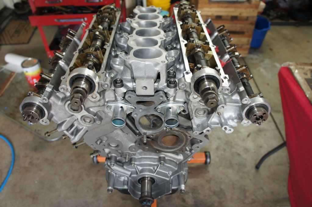

-Install adjustable intake and exhaust sprockets and degree cams to factory specs.
-Install leader gears.
-Install extrude honed upper and lower plenums.
-RameyZ idler studs.
Couple iphone pics in the bunch...sorry:

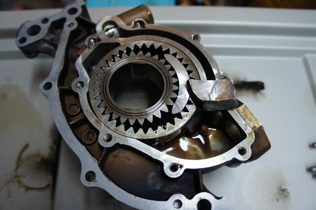

When I took my oil pump off I heard a rattle inside. Took it apart to find this:
No idea how long it was like that.
Cleaned up well for 186,000 miles:

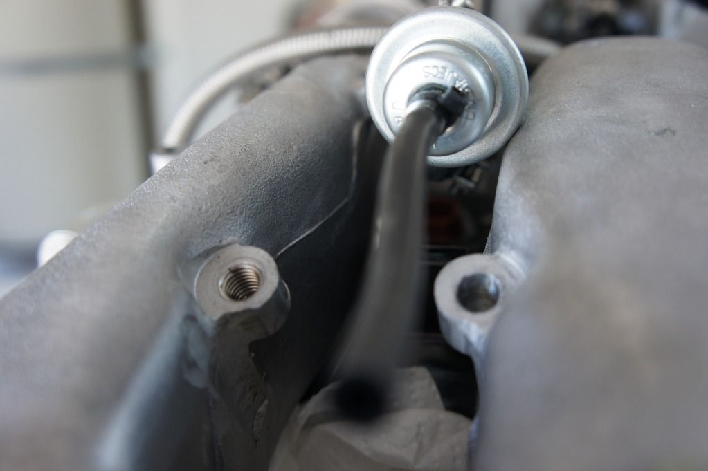

Had to heli-coil at least seven of the threaded holes on the upper plenum. Now I know why the guy was so anxious to sell me these plenums...jackass!
